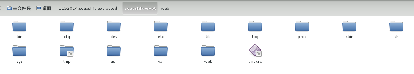

压缩包的格式可以确定是squashfs,也能看到LZMA压缩算法的特征(5D 00 00 01),但是用7zip就是解压失败,这个是磊科路由器固件的文件系统,需要解包然后再打包 ,但squashfs格式好像是变形的,试过好多工具都解不出来。我在网络上也查不到相关的squashfs格式结构的定义信息,无法确定哪里不对,希望有懂这方面的进来帮忙看看,谢谢啦!

用DD提取出squashfs文件系统再用7zip解压就OK了!

楼主,binwalk -e 加固件直接就能解开了,至于怎么压缩回去,得分析下文件头

用binwalk解不开,我试过了。
DECIMAL           HEX               DESCRIPTION
0                 0x0               TRX firmware header, little endian, header size: 28 bytes,  image size: 5480448 bytes, CRC32: 0x9DFE76B8 flags/version: 0x10000
28                0x1C              LZMA compressed data, properties: 0x5D, dictionary size: 65536 bytes, uncompressed size: 3956870 bytes
WARNING: Extractor.execute failed to run '/opt/firmware-mod-kit/trunk/unsquashfs_all.sh '152014.squashfs'': [Errno 2] No such file or directory
1384468           0x152014          Squashfs filesystem, little endian, non-standard signature,  version 3.0, size: 4090503 bytes,  914 inodes, blocksize: 65536 bytes, created: Tue Sep 24 16:43:45 2013

仔细看看报错再说嘛:'/opt/firmware-mod-kit/trunk/unsquashfs_all.sh '152014.squashfs'': [Errno 2] No such file or directory

[QUOTE=supertyj;1442137]仔细看看报错再说嘛:'/opt/firmware-mod-kit/trunk/unsquashfs_all.sh '152014.squashfs'': [Errno 2] No such file or directory
[/QUOTE]
你是说我ubunbu没有安装firmware-mod-kit吗?
